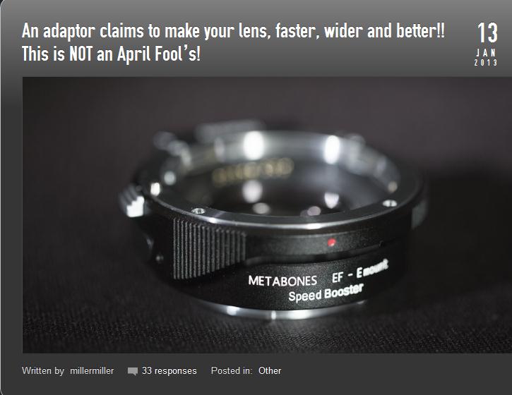

可以使你的镜头更广、更快、更清晰的转接环!!!
metebones即将推出佳能ef转Nex的自动转接环,可以将焦距缩小0.71倍(在nex上相当于等效全幅1.065=0.71*1.5),光圈提升一档,而且分辨率更高(不可思议),售价599美元。

What is the metebones ‘Speed Booster’?
In a nutshell, it makes your lens faster, wider and sharper Yes, really. Have a look at the film and tests below to judge your self.

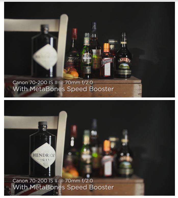

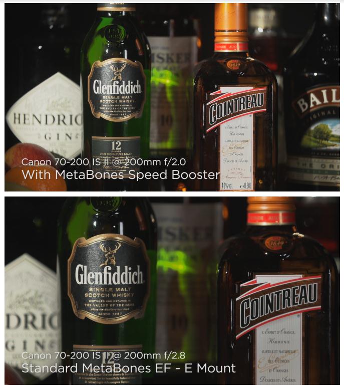

Does it work? Well yes. After what has been some very speedy non scientific tests, I am very happy with the images produced so far. From what I have seen, will I be ordering one on release? Again yes, yes I will. The adapter I’ve tested is a prototype, so final judgment should be reserved until a production version is used and tested. I love that I can have a real 50mm on the FS100. I really hope that Black Magic Design work out a live (electronic) M4/3 mount on their BMCC so I can use ‘IS’ lenses. It’s not going to bring the image up to full frame, but it will really help on lens choice. Of course, I would actually have to be able to get a camera first. But in hopes of a live M4/3 lens mount, this really does do away with the need for the EF mount version of the BMCC.

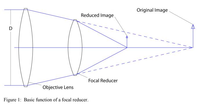

How does it increase the speed of the lens?
By the same way that a telephoto adapter decreases it. The ‘Speed Booster’ is placed behind the lens, so the entrance pupil of the lens (the aperture you can see when you look through the front of any lens) remains the same, but the focal length is reduced as it compresses the image, so the speed increases. (I think) The amount of light that would have covered a full-frame sensor is now focused onto the smaller M4/3 sensor and is therefore more “concentrated”. There is a maximum input aperture of f/1.26 and a maximum output of f/0.90.

It’s easy to assume it would, as you are all aware that teleconverters adapters basically will magnify the aberrations of the given lens.
The reverse is true for the meteBones ‘Speed Booster’ as it compresses the image and reduces lens aberration for the given lens. Of course, the adapter is not completely aberration free, but still taking this into account, there is a significant improvement in MTF compared to the given lens used without the ‘Speed Booster’.
All other aberrations, including field curvature, coma, astigmatism, distortion, and chromatic aberration are also well-corrected.” Wow that is a big claim.

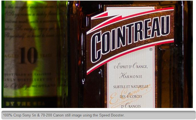

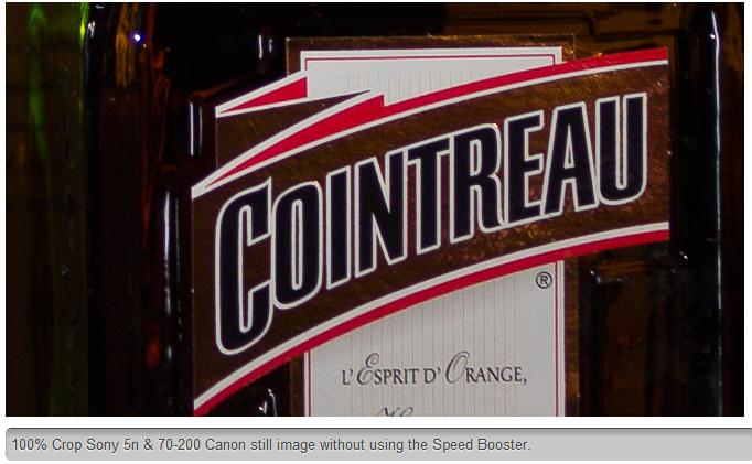

Of course the metebones Speed Booster is not just for video, it also does a great job in the stills area, and what better way to test resolution? I though this would be the weak point of the adapter but that does not seem to be the case.
Below is a very quick test using a Sony 5n E Mount camera. Shot at 70mm on the Canon 70-200 2.8 IS II lens. It looks like it does a really good job overall. I have not adjusted the expected exposure between the shots to match. I would have to do a few more tests to get an idea of corner sharpness. Also would be nice to test adjusting the physical distance of the camera to the subject to get the same framing.
